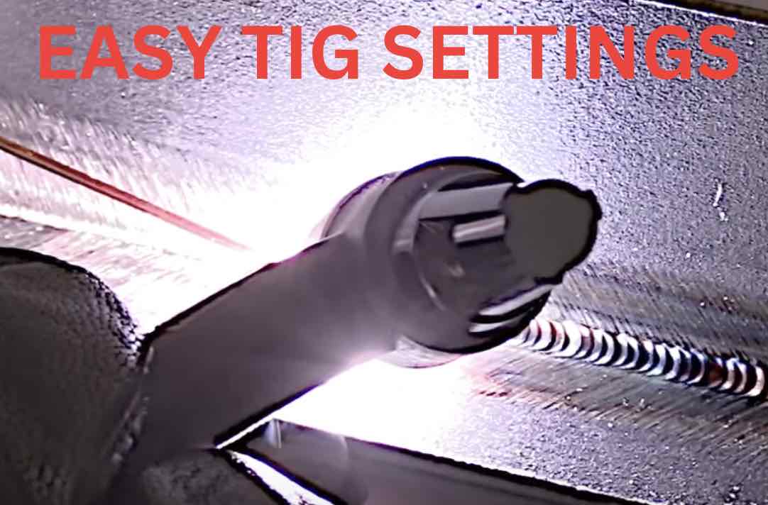

easy-tig-settings-2
Click here to see the first video on this page about gas tungsten arc welding with a primeweld tig225x and just how simple tig settings can be
Scroll down a bit for video on Easy TIG settings
