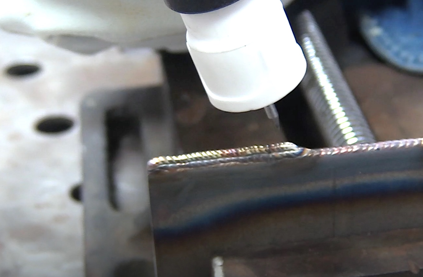

For this video page, I was a little bit rusty so I decided to just run a bead on the edge of some 11ga steel to show how high speed pulse settings work for controlling the weld bead on an edge.
Pulse Settings used
11GA COLD ROLLED STEEL EDGE BEADS BUILD UP
MACHINE SET TO 124 AMPS
ACTUAL PEAK AMPS 37
39 PULSES PER SECOND
30% BACKGROUND CURRENT
PULSE WIDTH fixed at 50%
#8 PRO CUP 20 CFH ARGON
3/32" 2% LANTH ELECTRODE
1/16" ER70S6 FILLER WIRE
I used a clear 8 cup for the first bead using 20cfh argon,,. and then switched over to a jazzy 10 ceramic cup with 25 cfh argon flow for the next beads.
I wasn't really planning on welding more than a single bead but decided to show how high speed pulse settings along with a jazzy10 cup work on building up an edge.
Using a larger cup with a secondary diffuser like the jazzy 10 shields a bigger area and makes for less discoloration.
Discoloration is not necessarily a bad thing by itself.
Discoloration indicates a layer of oxidation and oxides can prevent a bead from flowing easily.
In the same way that solder wont flow over an overheated oxidized copper pipe, a weld bead can be sluggish if the previous bead is oxidized too much.
So better gas shielding from a specialty cup like a jazzy 10 or furick ceramic 12 can help a lot on multiple bead welds.
