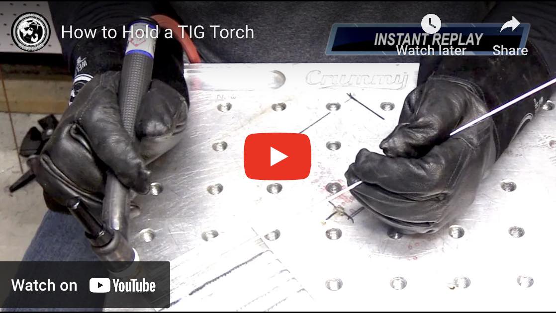

- Torch:
- Types of torches (air-cooled vs. water-cooled).

- Torch Handling:
- Maintaining a steady hand and consistent torch angle (typically 15 degrees from vertical).

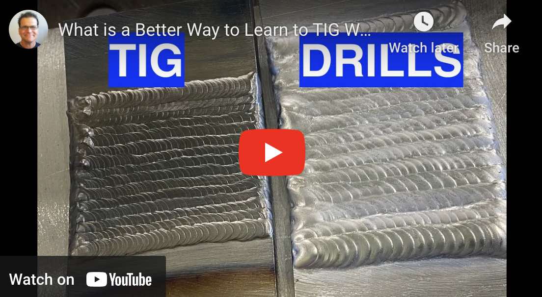

 VII. Practicing Welds
- Bead on Plate Practice:
- Running beads on a flat piece of metal to develop consistency.
- Basic Joints
After running beads on plate, padding beads on plate really helps build the motor skills needed to get better at tig welding.
