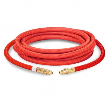

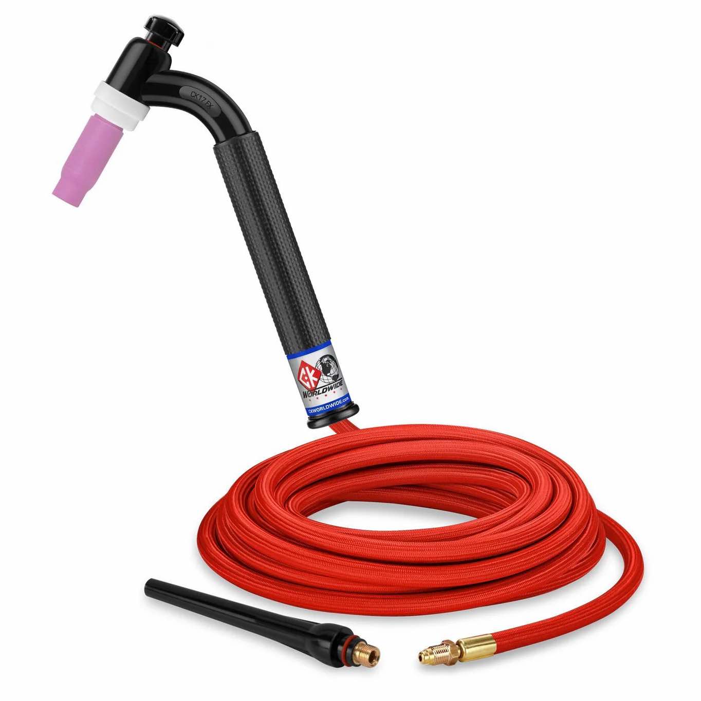

When it comes to air cooled TIG torches, the difference in the cables can be huge.
Some rubber cables are so stiff that they are difficult to work with....they actually pull on your wrist while you are trying to make precise movements turning a corner or rotating the torch while welding a coped tube joint.
Super flex cables feel like putting on loose fitting slippers after wearing tight dress shoes.
And att the end of a long day of TIG welding, you really notice a difference in how tired you are.
