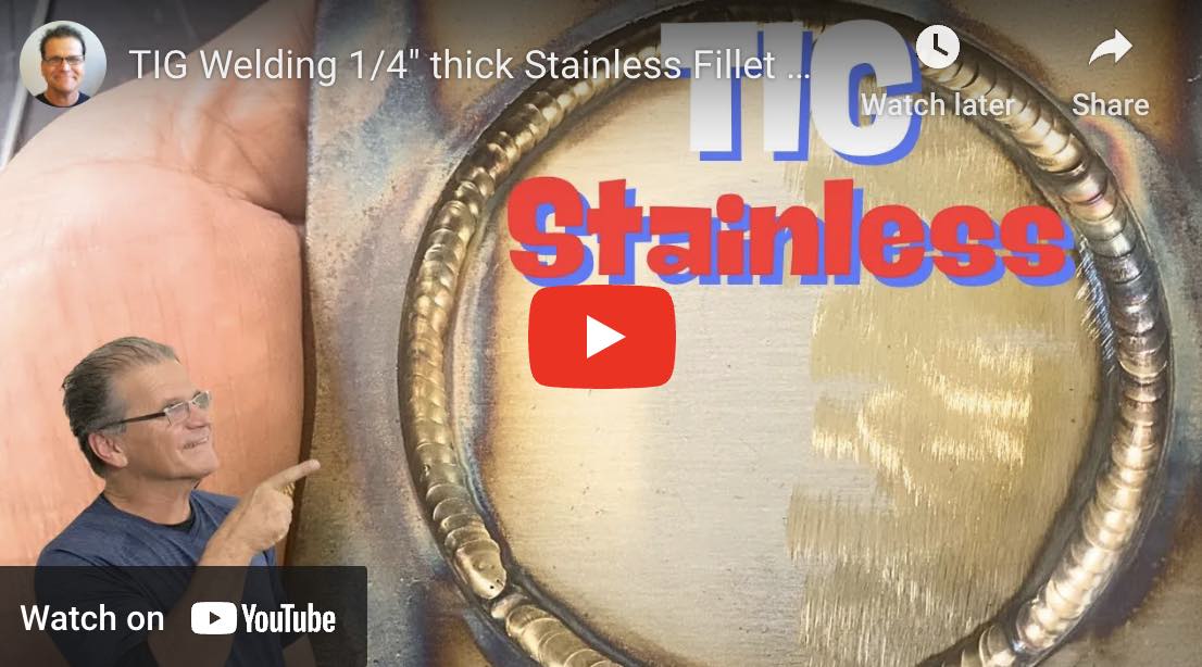

The Two main Challenges with TIG welding stainless steel are
1. maintaining stainless properties
2. controlling distortion
Watch the latest welding videos at Weldmonger.com
If you can already TIG weld carbon steel...
Good News...
learning how to weld stainless can be a pretty easy transition.
TIG welding stainless boils down to recognizing and following a few extra steps and best practices in order to maintain the stainless properties
