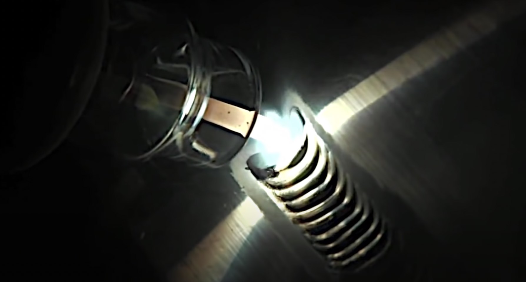

For the lap joint, I switched to a clear furick ally #5.
So many really good tig welders I know use a standard #5 cup for tig welding aluminum because it confines the etch zone.
The clear ally #5 does that too and it really helps me see and film the arc.
One key to getting good results with a #5 cup is argon flow rate.
With a standard #5 cup and a really short tungsten stick out, you can sometimes get by with only 12-15 cfh flow of argon.
But when I film the arc , I like to extend the tungsten a good 1/4" past the end of the cup and so I sometimes increase argon to 20cfh even with the #5 cup.
If you are not seeing the cleaning zone next to the toes of the weld, you might need more argon flow.
Argon flow rate and AC balance settings are related in how wide a cleaning zone you get.
corner joint
aluminum outside corner trailing
The first joint in this tig welding aluminum video is an outside corner and its 1/8" thick 6061.
AC frequency to 120hz and AC balance was set to 69% EN.
Amperage was set to 151 (round numbers are harder to remember) and I used a foot pedal.
I used 3/32" 2% lanthanated electrode along with 4943 filler rod 3/32" also.
The #8 furick cup really helps to light up the weld area which helps make for a better and more educational video as well as helping me see everything around the weld.
Amps on the machine read out at around 128
4943 has been around a few years now and  is similar to 4043 but has better mechanical properties and will respond to heat treatment.

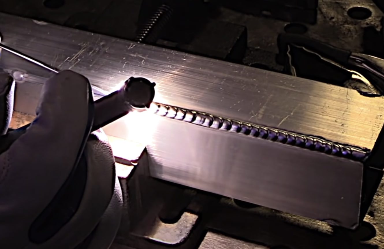

butt joint
aluminum butt arc
For the first butt joint on the square tube weld, I used a standard pink ceramic #5 cup
I used a dynasty 280dx along with a water cooled 20 style tig torch.
3/32" 2% lanthanated ( I use it on everything) along with 3/32" 4943 filler rod from hobart.
75% cleaning setting with soft square wave form and 120hz on freuquency.
The second butt joint was around .120" thick aluminum and I put a slight chamfer on each piece to help with getting full and consistent penetration.
I used a #6 stubby gas lens cup for this joint ( a good all around cup for aluminum tig welding)
amperage set to 140 amps on machine using foot pedal
15 cfh argon flow rate
30% cleaning action
3/32" 2% lanthanated  along with 3/32" 4943 filler rod from hobart.
