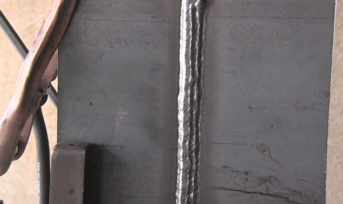

video clip #6 is a 3g plate welding test with a backing strap
This is a very common welding certification test and is often given along with a 4g overhead test.
This welding test uses a 22.5 deg bevel , a 1/4" gap, with a 1/4" thick backing strap.
Getting a good root pass is half the battle but each pass is important.
I welded the root pass with 120 amps
